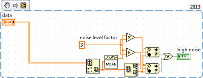

First of all, replace the while-loop with a for-loop with the "10" wired to it.
Then, I think you can detect noise level simplier using primitives instead of the Express VIs

Your "data" containes multiple channels. You surely do not want to average all the channels at once, do you? So, select a channel you want to check for noise. Build a mean of the values and find the min and max values. Build limits for your noise: average*3 and average/3. Check whether these limits are within the min and max range and display the output.

What is that first block that you put? An array subset?
