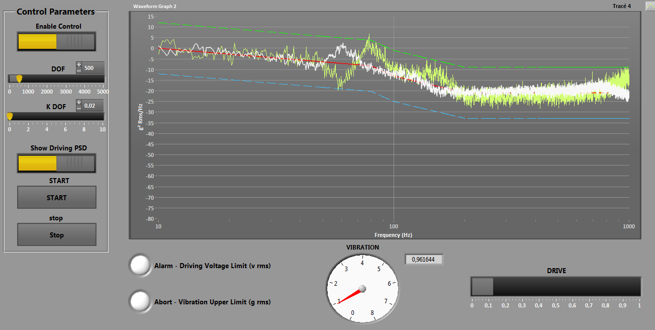

I modified my program by integrating waveforms for analog inputs and outputs to manage my concept of time. Look at this :
firstly i define my profile :
after i generate the response :
and now look at the evolution of the drive control :
For the moment i don't arrive to cut my frequency. In fact, my signal have to be in the range : 10-200 Hz but for the moment this is not my mainly problem i think . Can you explain why my enslavement doesn't work ?
