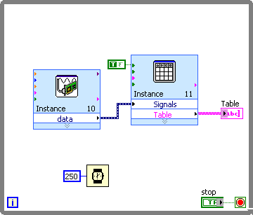

I guess I don't understand how you are using the function or using the table. If you have something like the picture below, the only data displayed in the table is the last result. You probably need to post your VI or an image of the block diagram.
