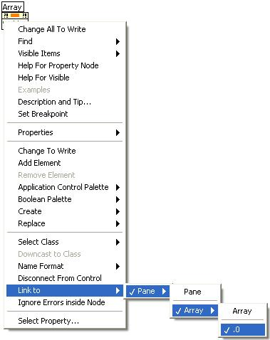

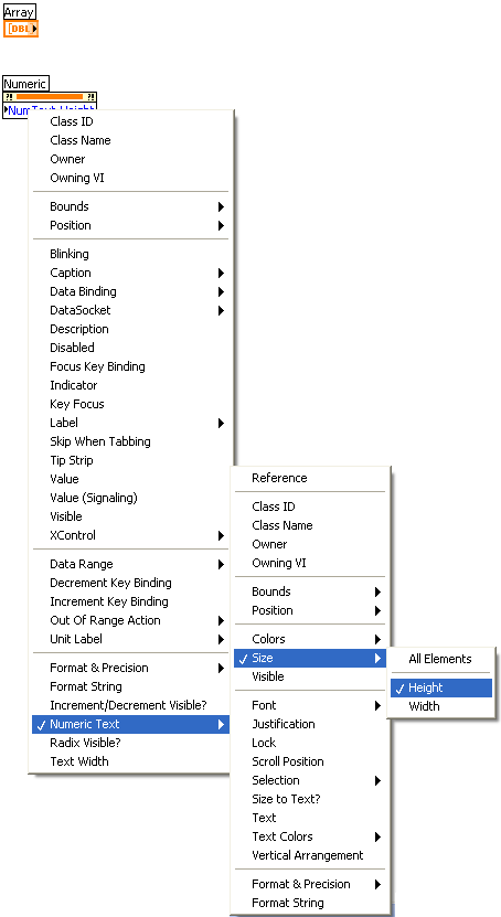

So you are talking about both images.
Here they are:
hope this helps,
Norbert 🙂

The property node Array Element»Bounds»All Elements of an array is read only. Therefore, while you can read the size of a control, you cannot write to it using this method. In order to change the size of a control inside an array, you need the property node for that control, not the array.
  1. In order to do this, create a property node for the array as usual by right-clicking on the array in the block diagram and selecting Create»Property Node»Visible (or any other property)
  2. Right-click on the property node and select Link To»Pane»Array»Numeric Value
  3. Now you can use the sizing property of the control itself to change the size by clicking on the property node and selecting Numeric Text»Size»Height
Note: You cannot have different sizes for each element within an array - they must all be the same size.
