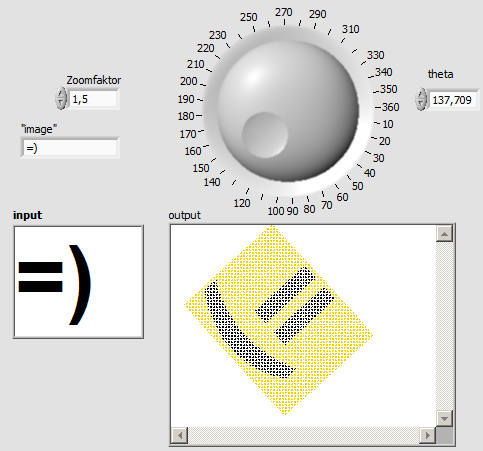

do you know about this thread?
If anyone wants to rotate an image around a different axis, they just have to figure out the rotation matrix and replace mine with theirs, so it's fairly scalable
http://forums.ni.com/t5/LabVIEW/got-bored-maybe-this-will-help-someone/m-p/1137515
