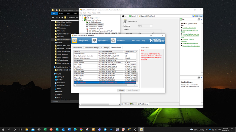

When I open VISA test panel, It appear in error message as shown in the picture.
Screenshot (242).pngYour solution will be really good for me!!!! 🙏

when your device (and its driver) does not support all the needed properties then you cannot use the VISA testpanel.
But you still can write your own test VI using all the VISA functions needed…
(2,059 Views)
Your device does not support that specific property, but as far as I know you can ignore this error and still use the Test Panel.
Paolo
