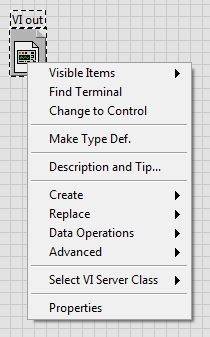

2. If you hit "Cancel" on the current snip process you put it into a kind of "triggered" mode. So, I can put my mouse over a drop down menu or other interactive component in LabVIEW, then press ctrl+PrtScn to call the Snipping Tool to action, and it allows me to snip whatever interactive components were open. For example, here is a snip of a right-click on a control that shows it being highlighted and the right click menu.

That is very cool, and much better that takinbg a screen shot of your entire display and needing to edit it down to the part you're interested in. Taking the microsoft video one step further, I created a shortcut to the tool on my desktop...
