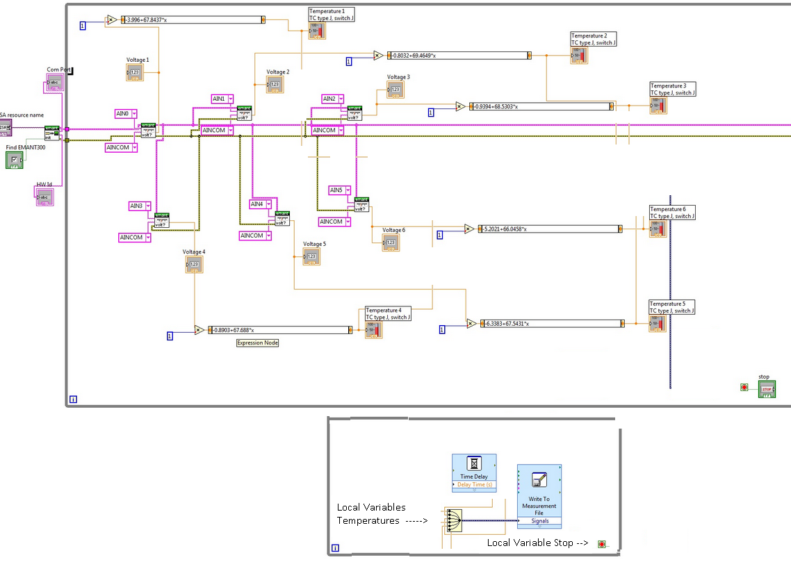

Hello. I am using LabView to measure temprerature with 6 thermocoplues at the same time. I've uplaoded the image of my block diagram. What i am trying to do is write the data to a file with the measurments beingtaken every 2 secs. I have done that with the Time Delay vi. However i don't want the Time Delay to affect my whole loop, because on the front panel the voltage readings and temperatures are also shown once each 2 secs. My question is how to make the Time Delay vi affect only the Write to measurment file vi?

If I understand you correctly, you want the while loop to continually update the front panel voltages.  However every two seconds you also want to log these to file?  Correct?

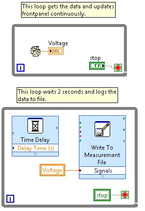

The easiest way I can think to do this is have two seperate while loops:  one for data acquisition and front panel updating, a second to log to file.
[Loop 1]
Keep your old loop the same, but remove the Time Delay and remove the Write to File.
This will allow your program to continually read from the thermocouples and update the front panel
[Loop 2]
Create a local variable for each front panel voltage and write them to file.
Add the Time Delay (2 seconds).
This is an example of what I mean:

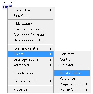

To make a Local Variable, do the following:
1. Right click the variable on the block diagram, select Create -> Local Variable
2. It will look like this

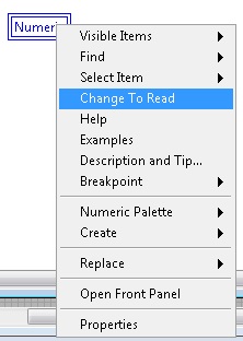

3. By default, they will be in "Write" mode.  Meaning you can use this to change the value.  You can right click the Local Variable to change it to Read mode:
Basically a Local Variable is a "clone" of an existing variable.  It allows you to access the value in an already existing variable.  You can read more about them here: http://www.ni.com/white-paper/7585/en/

It should look something like this (done very poorly in Microsoft Paint):
**One thing to note:  If you use a Local Variable to stop both loops (which you probably want), you need to change the Mechanical Action.  On the Front Panel, right click the Stop variable and select Mechanical Action -> Switch When Pressed:
