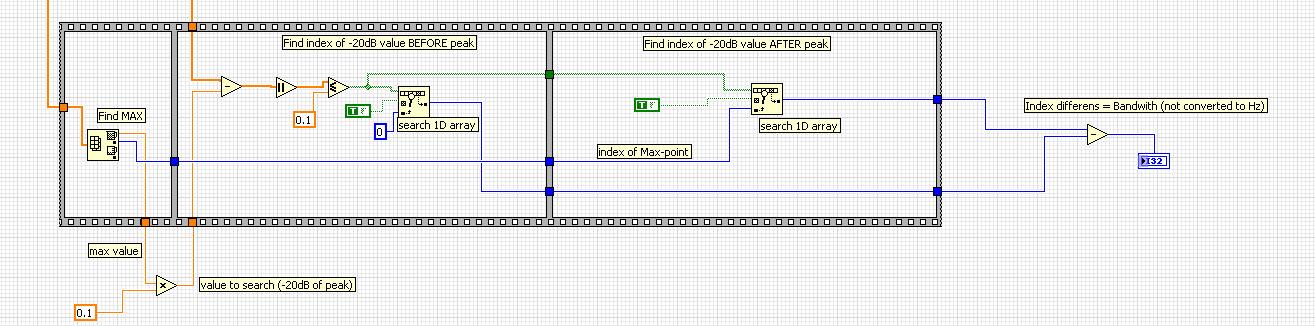

- First, the reason of the sequence-structure was because i had another solution before and was to lazy to change it right now:)
- I've attached a file that seems to work. but doesn't work on the real floating data.
     Can this be because i have no points that reach the aquirements? i really have no idea

your example VI gives a result of  "7", which is the difference of your "peaks" before and after maximum...
See attachment for some changes and some more indicators for checking of the algorithm!

I've been dealing with tis problem for a while now and realized today that i've done som wrong calculations. The test bw seearch VI you've improved made me realize this. It now works!!
Thanks alot for your incredible help and your time!
