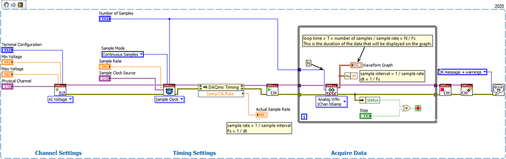

Waveforms and waveform graphs are best suited for equally sampled data where you acquire/generate/read/process multiple (N) samples at a time. The loop rate determines the cadence with which you get a new block of N samples; the sample rate determines the sample interval.
In this hardware-timed example, the DAQmx API puts all the timing information (t0 and dt) on the waveform.
Doug
