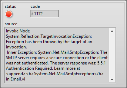

Thanks.  I'm running tests now.  I tried with the parameters you had set as the defaults, and got the following Error Message with information that I don't quite know how to process.  I'm also "on the road", so may not have as good a Network Path as I would at home or work, so I'll continue more exhaustive tests when I'm back home.
But if you could shed light on this Error Message (and, to use a phrase, "tell me where to go"), I'd be grateful.SMTP Error.png

The free servers is closed... gmail etc - authorising problem.  But many free smtp server working... Sendinblue - its working 2023 . with VI express email block...
Message 15 of 18
(1,618 Views)
You can stil use Gmail to send email, but you can't use the "Less Secure App" mode.  You need to enable 2-step authentication, then create an app password and use that app password in your VI rather than your regular password.
See - https://support.google.com/accounts/answer/185833?hl=en#
