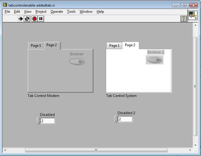

Thanks Harold for the small example.
Here is the modified one, which shows my problem.
I have added a copy of everything on your program, and the second tab control is of "system" type and there you can see the difference.
And I have also attached screen shots, for Ben, if he has no Vista on his computer.

when I change the background image to white it works fine because it is still referenced to the background of the front panel what you could do and this is prabably a long shot is turn the background white and place a image over the background (of grey).
