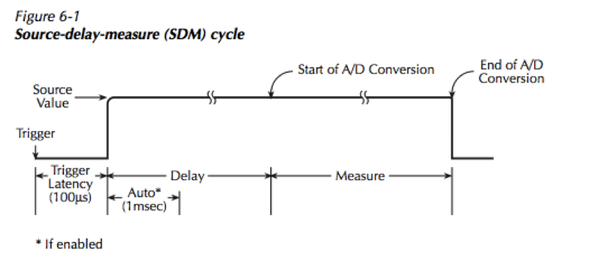

In the keithley 2400 user's manual, I found following in 6-10;

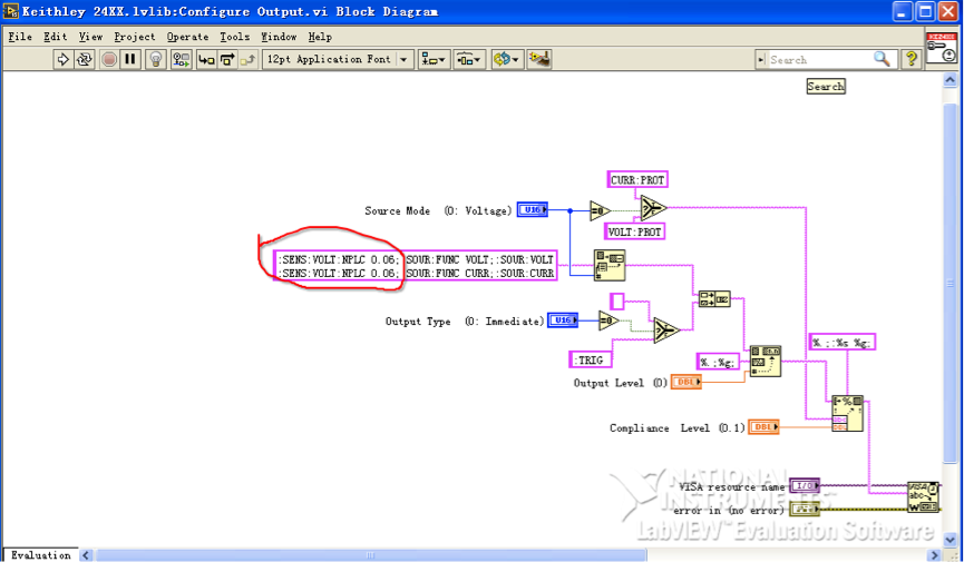

The attachment is my program.
I just want to source a sweep voltage with precise speed and measure voltage and current
simultaneously. To test the property of memristors.

I also can't see what's going on in your code because "Keithley 2400 Sweep.vi" was not included.

In the pic I post. Fig 6-1

I'm sorry, Serge, but I really don't see where the equation can be derived from that figure. Can you please send me resources so I can understand how this property actually works and where you got that equation from? I see that it is Delay+Measure, but how do you figure Delay is NPLC*Frequency? If I can read through this resource I can try and figure out what might be the issue here.

http://research.physics.illinois.edu/bezryadin/labprotocol/Keithley2400Manual.pdf
NPLC properties are described on page 194 (section 7-7) under the heading "Speed."
Additionally, trigger delay should also affect the time between each step.
