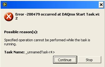

Thank you for you answer. I modify the programe as you said. But there are two problems. First, The trigger singal only been sent once, I mean the part in the loop seems works once. Second, when I stop the program, thers is error window appear. How to slove thme, thx very much.

Put the "Start Task" function outside the loop also.

Thank you very much. The error window doesn't display anymore. But the trigger singal still only send once. What could casue this problem?
