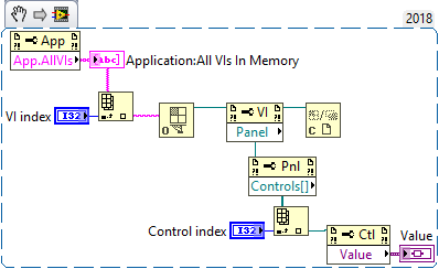

Just use VI Server (search for it) to open VI references, then control references.
Make sure the VI doesn't have separated complied code, and drop it on the exe in windows explorer.
I wouldn't know what to make, as I have no idea what your application look likes.
As a first test, try to get this to work:
There are caveats. Not all VIs will have a front panel for instance. This test won't do anything useful with the wrong VI index and Control index. But for GUI VIs you should be able to get control values. And set them. Often, the value will be overwritten by the program. But if the GUI VI has value change events, a value (Signaling) will trigger the event.
