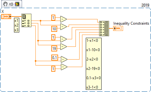

Thank you so much Sir, i have seen the example you provided, if inequality constraints are within bounds than how it can be written like if
1<x1<10
2<x2<19
0.1<x3<1
than how we can write inequality constraints please guide Sir

1<x1<10 is really two constraints:  1<x1 and x1<10.  So you now have six inequality constraints.  Do the math.  And who is this "Sir"?

Bob's suggestion to decompose the compound inequality constraints into simple constraints is the place I would start.
As Bob stated, "1<x1<10 is really two constraints:  1<x1 and x1<10.  So you now have six inequality constraints."
So your set of constraints:
1<x1<10
2<x2<19
0.1<x3<1
Becomes:
1<x1
x1<10
2<x2
x2<19
0.1<x3
x3<1
From my earlier post "The inequality constraints are specified to be less than 0."
So rewrite the six inequality constraints to be of the form "expression<0"
1-x1<0
x1-10<0
2-x2<0
x2-19<0
0.1-x3<0
x3-1<0
Now implement the left side of the equality constraints in your cost function. Below is a snapshot of an implementation.
-Jim
