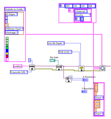

I am new for vision, i try to find the contour from the pic, but always report that the ROI is not correct.
Could someone give some examples for how to define this ?

Maybe you could use NI Vision Assistant to generate a vision script. It is much easier to defines ROI or such things with that assistant. Then you can create a VI out of your script.
For your answer, Global Rectangle Array ROI Descriptor is responsible for ROI.
From upper-left corner of image in pixels: left-edge, up-edge, right-edge, bottom-edge :

Hi Sir,
Sorry, still report "invalid ROI", do you have any samples for capturing the contours, dots, distance/angle calculation ?
