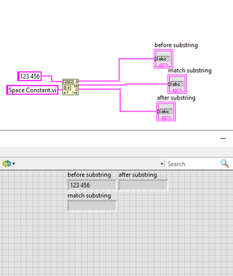

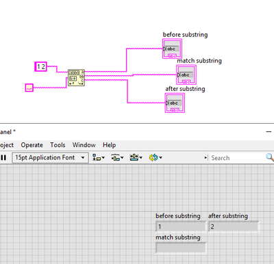

I tried this method but its not working for me.

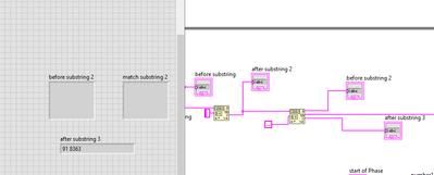

Its working fo me.Thanks.I have more question.I am basically receiving these values via serial communication.This is working for me for normal string but when I am trying in serial communuication it is not showing anything.Thanks for your help.
For normal string working.
For serial communication not working:

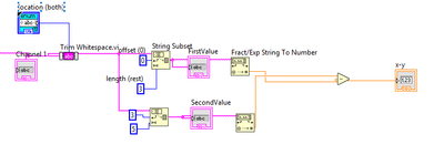

I used Trim Whitespace to delete the space at the start and end.I tried  Match pattern and spreadsheet string to array and scan from string but nothing is working in Serial communication I finally used String Subset.I dont know why nothing else is working for Serial.

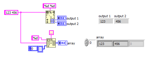

This is not good for you, since both Spreadsheet string to array and Scan from string work if properly used.

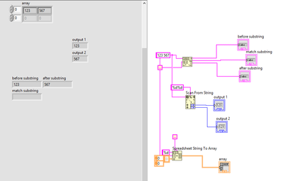

Thanks.
Spreadsheet string to array and Scan from string are working for normal string but not in serial.I tried all the possible ways.
