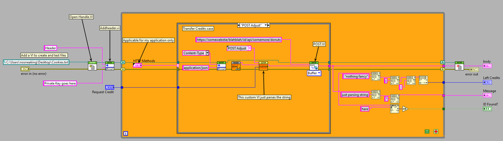

I am fairly new to LabView, but following are the few things I implemented and used in Web API- LabView communication using HTTP:
1) Finding VIs: Functions Pallet- Data Communication- Protocols-HTTP
2) Block Diagram for GET: (Use private key only if applicable)
2) Block Diagram for POST: (Use private key only if applicable)
I hope this helps in someway.

What are the while loops for? They don't do anything...
Other than the while loops and the coloring of the structure diagrams that is the way to do it.
Yes Sir! my mistake, while loops are there as part of my template VI. But yes, it does not do anything.
Please now that I am new to LabView, actually 6 months into any kind of programming. So yes, I am playing with every possible thing that I come across in LabView including background colors.
