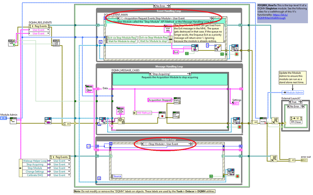

I need a helper loop in my dqhm module but its unclear for me how to stop it. In the CML example project created by Delacor the helper loop subscribes to the Stop module request. The event handler loop subscribes to the Stop module request as well which seems to be a bad solution as NI recommends not to handle the same event in multiple event structures. I know that this solution is legit as I have seen a video which describes that these events are not the same, but I can't find the vid.
Could you explain how is it OK to stop the helper in this way?

EDIT: I have found this topic: https://forums.ni.com/t5/LabVIEW/multiple-event-structures/m-p/1174119#M510673 saying that handling the same event in multiple event structures is fine IF we do the registration to the events like the one above. So the top and the helper loop actually processes the same event, but in this way its OK. Could you confirm that my understanding is correct?

@1984 wrote:
I have found this topic saying that handling the same event in multiple event structures is fine IF we do the registration to the events like the one above. So the top and the helper loop actually processes the same event, but in this way its OK. Could you confirm that my understanding is correct?
Yes, that's correct. Having multiple Register For Events nodes registered for the same event is fine. The thing that's *not* fine is taking the event registration reference output from a Register For Events node and wiring that to multiple event structures.
