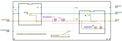

If not, can you give us an example of how you have it structured? Seeing what you've done can tell us SO MUCH MORE than words can.
Sure, see the BD below.
How does it work:
  1. If no error occured so far then this VI does nothing
  2. It handles errors in two ways:
    1. An error comes in. In this case the the error is stored in the "ProgramEndGroup" container. The storage is done by the leftside VI in the middle, the mechanism is not important
    2. The second VI in the middle reads the "ProgramEndGroup" container and passes out any error stored there as well as it outputs TRUE on its output. This means if any VI anywhere in the application threw an error to this container then this VI outputs that error
    3. (its easy to see that if an error comes in or an error occured somewhere else then from that point the error cluster from the middle will always have that error)
  3. As a result if an error occures then the VI latches the "Program end" boolean TRUE, latches the error out and the generates an App exit event once.
  4. If no error is occured but the "force program end" is TRUE then the VI generates one event, latches the "Program end" boolean TRUE and throws a custom "program end" error to the "ProgramEndGroup" which ulitmately latches the error output as well
(there is nothing in the other case of the case structures just passing thru the inputs)
(Generating the event once is a problem which I have described earlier in my posts so the most actual version of this VI  (not attached) generates an event everytime its executed and an error occured, meaning that AppExit event is generated multiple times)
This VI is used in two ways:
  1. there are some VIs executing continously running loop(s). At the end of the current iteration this VI is called and used as an exit condition (either the error output or the Program End output based on the part of the app). This is the "POLLING" usage
  2. There are VIs using an event structure. For these VIs this VI is placed before the event structure and the structure registers to the App exit event. This is the "EVENT BASED" usage of the VI.

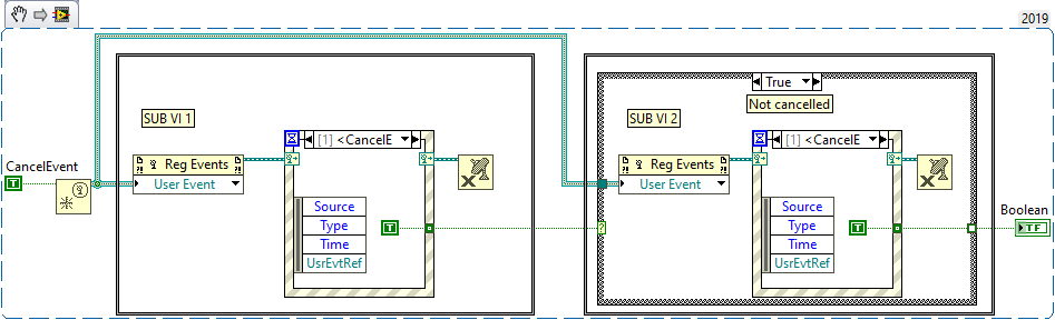

I'd do something like this:
Qestit Systems
Certified-LabVIEW-Developer
Message 16 of 18
(2,625 Views)
