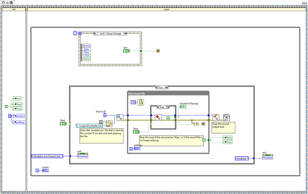

you may look at
"C:\Program Files\National Instruments\LabVIEW xxxx\examples\Graphics and Sound\Sound\Sound Player.vi"
(3,248 Views)
Accepted by topic author Ngouda
@alexderjuengere wrote:
you may look at
you then want to build around this e.g.
Spoiler
(3,238 Views)
Hi @ZYOng, @Yamaeda, @alexderjuengere
Thanks you all for your reply, that works now 🙂
