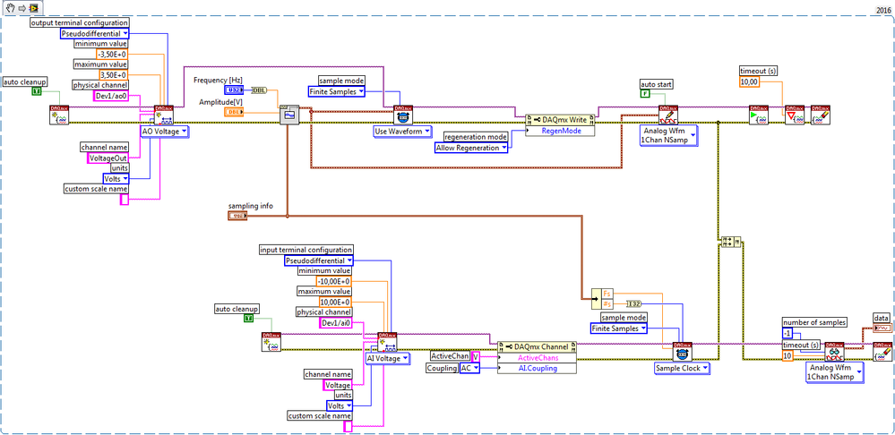

How to synchronize DAQmx AI/AO finite samples?
I'm trying to implement an audio generator/analyzer with a NI USB-4431 DAQ card. A sine wave should be generated at the analog output and be measured at the same time at the analog input. There used to be an example "Multi-Function-Synch AI-AO.vi" in previous LabVIEW versions, but unfortunately it's not shipped with LabVIEW 2016 anymore. I found an example HERE, but I have a slightly different setup.
The example uses Continuous Samples, whereas I'm working with Finite Samples (because I don't have a stop button in my application). Currently I'm using the error lines to synchronize the output and input tasks. Is this the right way to do? Or is there a better solution?

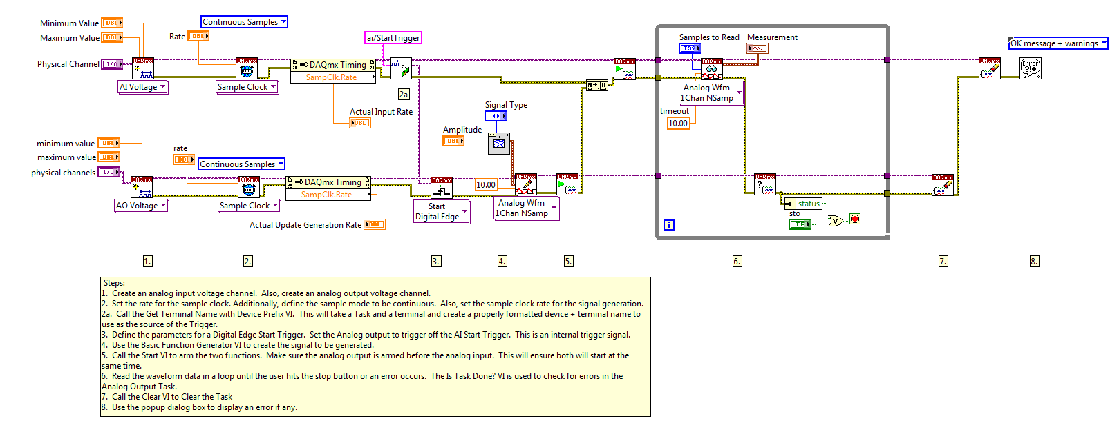

Hello Dietmar,
There is a small mistake in your code.
The right implementation can be found in this link
Multi-function Synchronization for AI and AO
Try to use the same concept where you set the start trigger signal in one channel, and waits for that signal in the AI channel.
