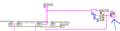

As I have taken 1D string into Property node of combobox and there are various Items to select from combobox.
I want to know what item got selected from comboBox and want to use it as a string for further conditional command. So how to take output from combobox selection.
 i wand output from the array where i have my comboBox
