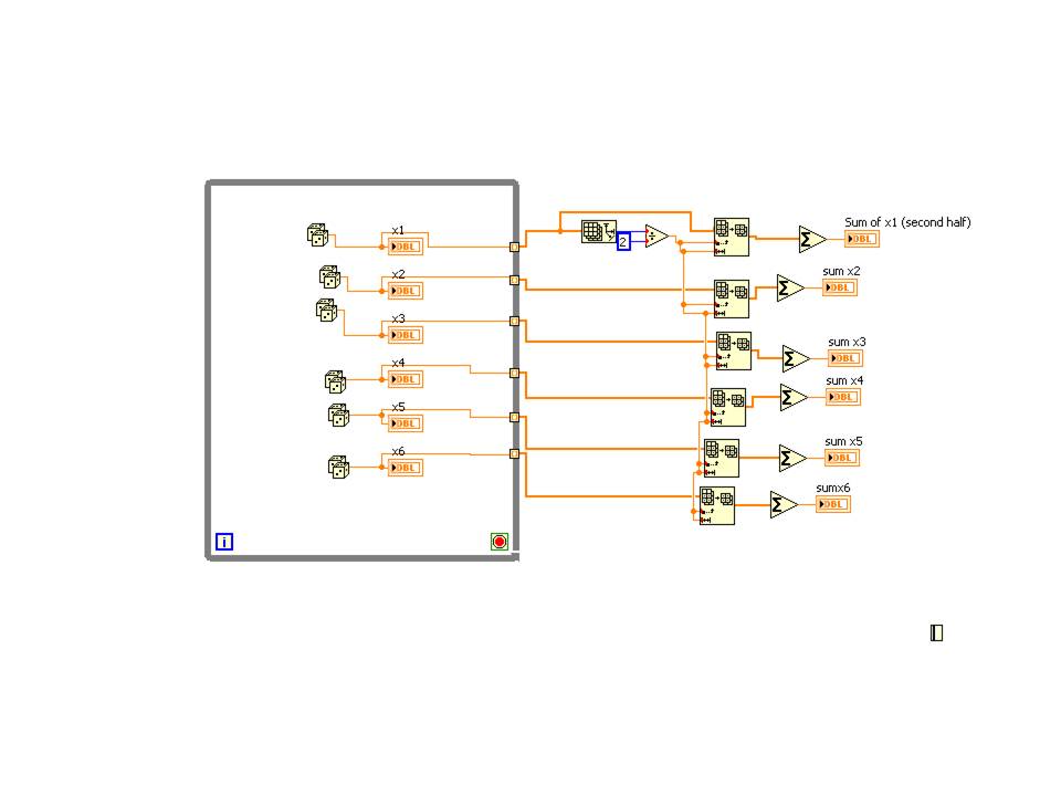

I'm not going to mess with your control design thingy... but here is the simple and direct way to take the sum of the middle to last interation.  I'm using random numbers here, but you can fill in your own values once you get your formula straigthend out.
Basically, it works like this:  feed the values into an indexing tunnel.  That will make each set of values into an array with length N where N is number of iterations.
Find the size of the array and divide by 2.  Remember that arrays start at index zero, so 12 iterations will give you 0,1,2,3,4,5,6,7,8,9,10,11.
You want the second half, so that's 6,7,8,9,10 and 11.  Use array subset to pick out 6 elements starting at element 6.... then take the array sum.sum array.jpg

Because the simulation loop is inside the While loop, they cannot be synchronized.
What happens is this:
  1. The while loop starts
  2. Everything inside the while loop runs (including the simulation loop)
  3. The simulation loop runs until it is complete (this might be once or many times)
  4. The while loop does not start again until the simulation (and everything else inside of it) is done.
Each time this happens, one value is placed in the output of the while loop.
The first thing you need to do is delete the random number generators that I put in.  These were just there for demonstration purposes.  You should wire the output of your X1, X2, X3, etc to the outputs of the while loop (the tunnels at the right edge.)  If not, there's no way for your data to get out of the loop.
Also, I'm really worried about the simulation loop.  In fifteen years, I have never needed or used this feature.  I've done quite a lot of complex math and I've always built my functions from the basic LabView toolset.  So I can't help you with that part, but I really think you'd be better off if you  got rid of it.
