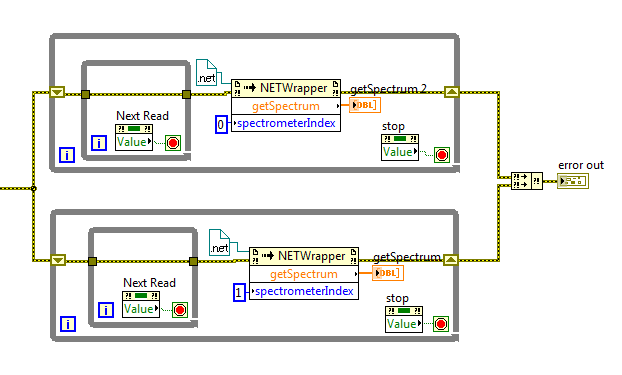

Is there a way to know when Labview will run a set of commands together or in parallel?  Is there any kind of post-compile tool that can report this?
I was trying to read from two Ocean Optics USB Spectrometers at the same time.  My originall code (illustrated below) ran one command at a time in series.
Once I separated each command into two different while loops (illustrated below), they ran in parallel.
To me it seems both should run in parallel.  Is there a way to check how labview will build a block diagram and remove the guesswork?

LabVIEW is a Data Flow language.  If there is no "dependency" between two pieces of code, LabVIEW will try to run them independently of each other.  Both your original illustration with two "getSpectrum" calls, and your lower illustration with the two calls in parallel loops should run in parallel, unless (of course) the "getSpectrum" function is a single thing that only exists in one place and runs at one time.  [That's a bit vague, isn't it?  The analogy is you and I are in a restaurant and each order a hamburger from different waitresses.  They (in parallel) to go the cook and say "Make a hamburger", but there's only one cook, and his grill is too small to make more than one hamburger at a time, so he is forced to "serialize" the two parallel requests.

You are building the block diagram and the compiler will compile it. Yes both loops will run in parallel as much as the hardware allows. Of course there could be issues of reentrancy with the .net stuff and LabVIEW has no control over that.
Of course just looking at your code, the blatant overuse of value property nodes and greedy loops tells me that you are a brand new LabVIEW user. Maybe you should familiarize yourself with the simple stuff first before trying to tackle advanced tasks. Have you ever looked at the CPU use when the program is doing nothing but waiting for the next buttons???

Can you show us the entire code of the upper picture without the truncation on the left and right
haha new user yes.  I made that as a quick illustration and is not code I'm running.  My actual code is more complicated and I use Wait until next ms multiple commands in my wait loops.
On the value property nodes I have no idea what overuse would be.  If you can take a look at my real code and let me know if there is any, I would appreciate it.
Message 8 of 22
(4,659 Views)
I can but... I re-wrote it already, so I'll have to make a copy and put it back to how it was.  I don't think it'll take too long and will post when I finish.

Perhaps you have two .NET refs in the lower one, but only one in the upper one?  So in the top one, the cook has only one burner but in the bottom he has two?
