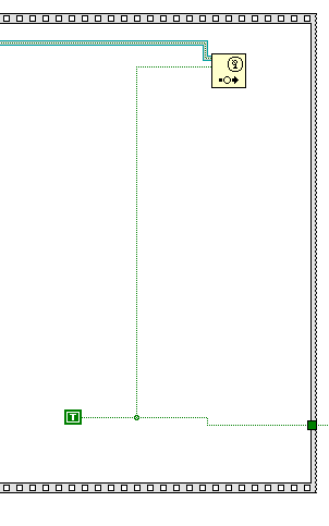

Your While Loop waits the For Loops to stop, so you can use local variables of your stop button to stop the for loops right away.
Cheers,
Jimmy

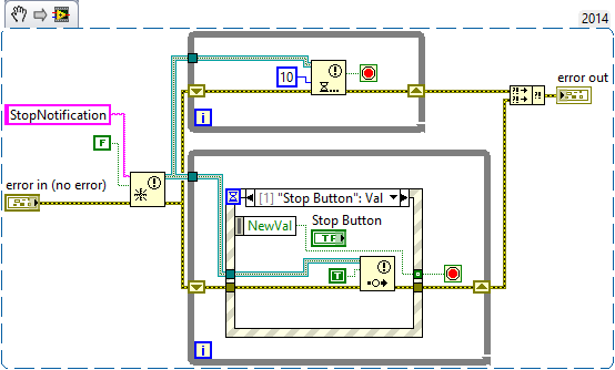

If you want to avoid the Local Variable, a standard way to do this is with Notifiers. Use the same construction that Jimmy has and then add a parallel while loop with an Event Structure that can throw the notifier when you hit the stop button.
Your architecture is a bit odd. You have the makings of a state machine that could be expanded to not use a for loop and be completely interruptible. Also, your flat sequence structure isn't doing anything for you.

Thank you Sir for the reply. I tried the local variable before, the challenge is that I must then change the mechanical action of the stop switch.
Changing the action of the Stop button is easy and I do it a lot. It's a really easy way to make a local stop variable for multiple loops. Change the Stop button to "switching" mode and then write a False value to another local variable that runs after all loops have stopped.
This is your easiest solution.

Here's a template for the alternate solution I was proposing. In this case, I illustrate with a while loop instead of a for loop.

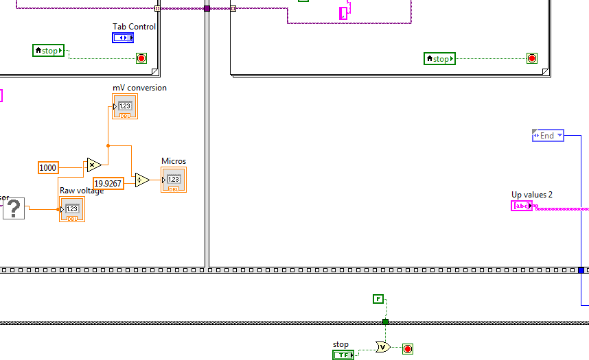

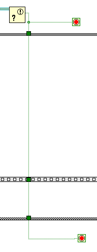

You'll still need a way to kill the event loop. You can use a user event for that.
Kill For loop and daq loop
Event loop:
Event loop:
Thank you for this. I have been trying to learn how to use events, as it seemed the better way to go for my entire project but I haven't figured out how to use them yet.
