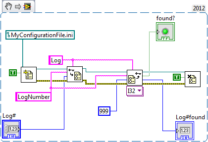

you can get an array of the files in the directory and scan for the highest number....
or use the the ini-file vis to write that number before exit (or after each file written)
here I first wrote the key  ... however I hope you got the key 😉
