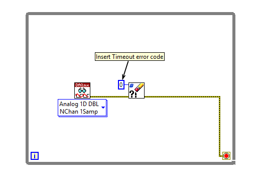

I beleive LabVIEW creates new session everytime DAQ is initialized but you can still try the below method to bypass the error.
Just insert the error number which you get when the device is disconnectedbypass.PNGbypass.PNG
Let me know if it helps you.

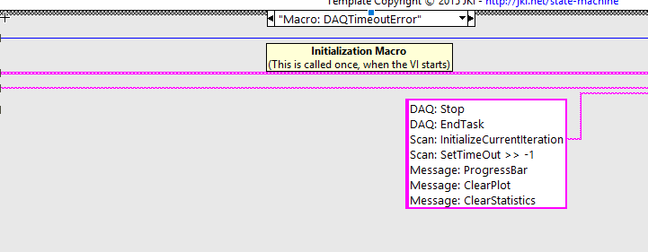

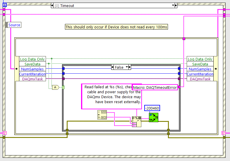

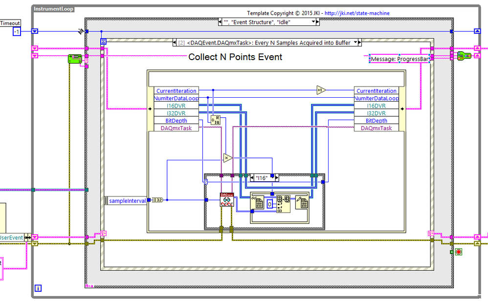

Unfortunately due to company policy I cannot post it. But I can describe in more detail what I did along with some pictures.
  1. Look at the example DAQmx Continuous Acquisition with Events.
I use an Event Structure that tells me when N number of points is ready from the device, in my case I choose N such that the time is 100ms. (For example if my sampling rate is 1kSa/s, then N is 100 samples) Before starting the acquisition I change the timeout on my Event structure from -1(infinite) to something like 500ms. If I go to the time out state then I know my DAQ did not read in 100ms and something went wrong. I then start a sequence of events to clear the error, clear the task etc, send a message and wait for the user to respond.
mcduff
N points eventN points event
timeout errortimeout error
Ignore the comment, never changed itIgnore the comment, never changed it
Message 7 of 8
