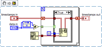

Hi Vinal,
something like this should get you on track:
18713i1EE3B4E93A7C4D4F
"Timestamps in" and "data in" have to have the same array size...
