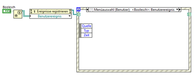

Found tutorials about how to create dynamic events. But when I add a dynamic user event to the event case, the original source becomes unavailable. The option to merge several events
into one case appeared to me like a logical OR.

I wonder why no one looks at the pictures I showed above. Accessing the custom menu triggers an event, the MenuItemTag is read into a multicase (not shown in the simplified VI). OK, new image:
That works fine. Adding another case to the same event kills the tag:
MaSta_1-1668681510344.png <-- doesn't work anymore. OK, so what options do we have? If I change the case to:
MaSta_0-1668681703925.png it will give a menu ref which I can process, but trying to add the other case here does this:
MaSta_2-1668681858893.png which is pretty much the same as above. You cannot mix events in one case which are dependent on refs or specific sources. Seems illogical to me.

@MaSta wrote:
the primary goal is to go into the same event from two different case triggers.
As you already found out only data which is common to both (multiple) events will be available in a single event case. There is nothing you can do about it. How should LabVIEW fill the Item Tag value, when you generate your boolean user event?
@MaSta wrote:
I cannot create a user event for a menu action.
You can create a user event with the information from the menu you need (just Item Tag, or a cluster of Item Tag, Item Path and whatever you need) and generate this event in the menu selection case, which will forward the information to the user event case. Yes, now you have two cases, but perform the operation only in one case.

Your User-Event needs to have the same information as your event that is triggered in the same Event-Case.
Just add a Cluster with that Information (I missed the VIRef). Make sure you give that Information if you call that event manualy!
