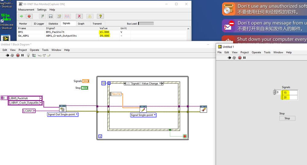

Adding XNET write.vi into your "signal data: value Change" event can solve your problem.

See the picture, and then you can understand.
