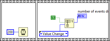

When configuring an event, in the "Edit Events" dialog, there is an option that is selected by default: "Lock panel (defer processing of user actions) until the event case completes".
When this option is selected, only one event is processed at a time. If you flush the events in the "String value change" event, the "Ok button" event is not available to flush yet.
If you uncheck that option in the event config, you should see the expected behavior... except that in my case, I had to add a 100 to 200 ms delay before flushing the events for the "Ok button" event to disappear. If you use Execution Highlight or set a breakpoint, it works as well.
