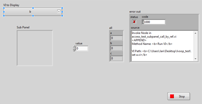

OK, I see the problem.  You're calling a class VI with a "required" input but you're not giving it the required input in the first loop there.
You need to run the VIs using their connection pane each time, like you're doing in the "value change" event.  The "Run VI" invoke node doesn't work with any VI that has a required input like that.

I looked at the first loop, but I can not find the unconnected connector you mentioned.
The error is generated in the loop, where the member VI gets called the first time.
Also I still get the same error, even after I changed all inputs to recommended.

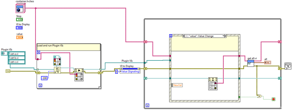

Below I attach snapshots of the block diagram and the error message.blockDiagram.pngfront_panel_error.png

Instead of the Run VI invoke node, use the Start Asynchronous Call.  Then you can supply the needed inputs for the VI.

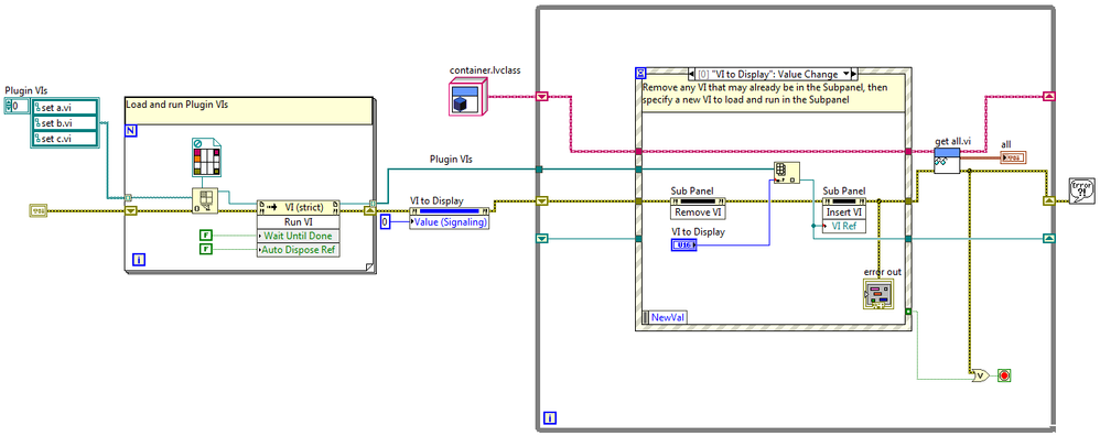

Ok, the first part works: Load member VIs into subpanels.
What does not work is: Using the controls of the member VIs (loaded in the subpanel), to change the values of the class variables, as read out by the "get all" member VI.
Also the program produces a time out at the "wait on async call subvi", when I change "value" the second time.
Do I need to adapt the event structure to watch for changes in the loaded subvis or wire the class wire differently - isn't it bad, that it branches, or is it ok due to the wait on async call subvi?

It appears that you're missing one of the fundamental properties about classes in LabVIEW, in that they're all value-based.  Not reference-based.  Unlike many other languages, you can't manipulate a class in two separate locations just by copying a pointer, which is what I think your program's structure is based on.
In the first loop, where you run it 3 times, you're creating 3 separate instances in memory of the container class.  The "set" VIs all run once, (presumably doing nothing but setting their respective value to the default of zero one time) and then all of the subpanel VIs terminate, and then you can get the output values back one time and only one time per "set" VI, as the "collect" node you're calling in your event case gets the values, and when you try to get the values a second time, the VI didn't run to begin with, so it times out.
If I'm correct, you need to change your overall design to one of two things:
Option one: Convert your class object so that its data is internally stored by reference, so when you copy it you copy the reference.  You could consider using either a data value reference or a single element queue (see the "Reference Object" example in your "labview\examples\lvoop\ReferenceObject\ReferenceObject.lvproj" directory, assuming it still ships with 2017.  If it's not there, just google "Single-element queue" to find out more).
Option two: Set up all of your sub-panel VIs to run continuously (i.e. they all have a "While" loop in them) in parallel with your main VI.  Then arrange for them to pass information back and forth by some means.  You could use a Queue, or user events, or a functional global variable/action engine.  The exact method is up to you but the main way it would work is that you keep the one true copy of the data in one location, and you have a method of either sharing access to that location that is restricted to only one VI at a time, or have one location that does all of the reading and processing and the other locations are restricted to messages either instructing it to perform operations or to send information back to a requester.
