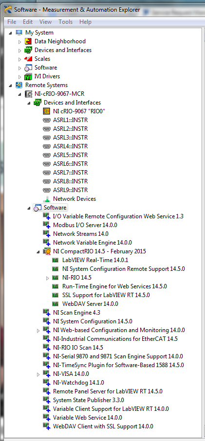

I built several systems using the cRIO-9067 controller with 2 NI-9144 expansion chassis and 2 NI-9871 modules.  The 9871 only operates in scan mode and is configured by a specific 987x driver that must be running on the RT controller.  When configured with the matching 987x driver on the host computer, the 4 ports are visible in MAX (see image).  Even in my configuration both 9871 modules had to be installed directly into the controller.  They were not recognized in either  expansion chassis.
You need to buy cRIO controller that runs LabVIEW RT and install the drivers.  The code can then run on either the RT or the host.
