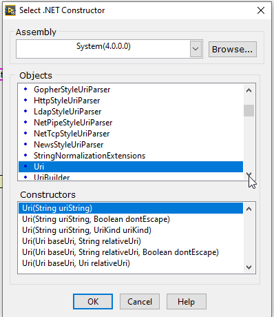

Thank you,
I'm not familiar with MSDN and when I open the "Assembly" drop-down menu to look for something, it seems like ... chaos!
I found that inside "System(4.0.0.0)" Assembly!
There should be some kind of filtering so that it will be easier to search for the contents / available assemblies!!!
In any case your new proposal is working much better, I had to add some "wait" functions in order to avoid the LabView freezing!

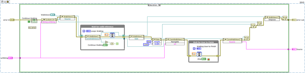

Message 17 of 32
(6,959 Views)
Hoping this will be useful to others!  Clearly, it needs to become a state machine to handle resize events, panel close, etc.

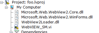

An additional tidbit, is that for stand alone exe usage must include three dlls either in the exe root folder, \data, or \bin.   The WebView2Loader.dll is in a slightly different path than the other2 and must be explicitly added to the build.

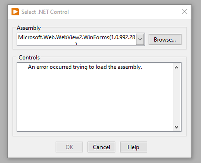

This thread has been very useful, thanks.
I'm very close to getting this up and running but I have run into one snag when trying to select WebView2.WinForms.dll as a .Net Control
Has anyone had the same problem? Any suggestions on how to overcome this?
