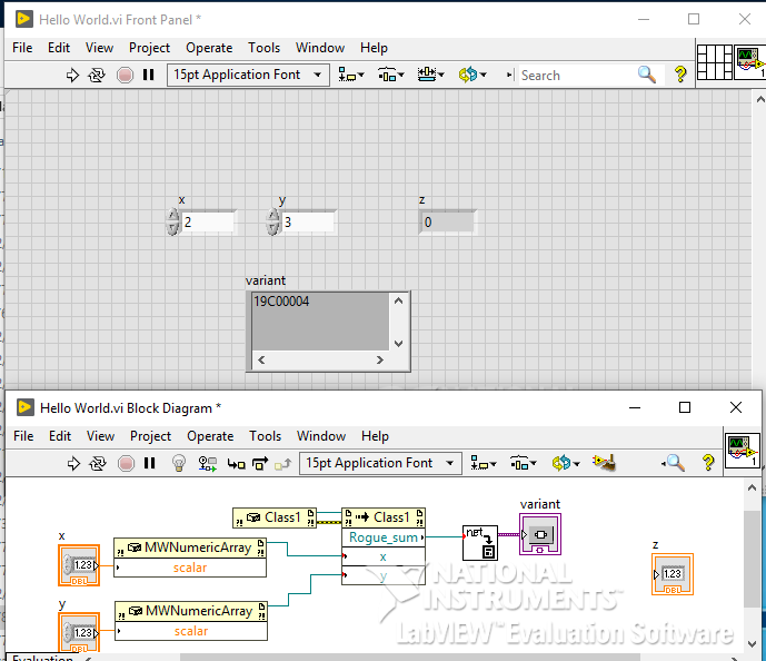

Mr Builder,
Thanks. So I wrote a simple "Hello World" function in MATLAB that adds x and y with a single output z, then generated a .NET assembly containing the function "Rogue_sum". I found the MWArray.dll buried in the root directory of MATLAB, and used it to create this LabVIEW code. It runs without error, but the output is some HEX string I don't know how to parse. How do I read the output? Do I need to invoke something from the MWArray dll? Can you please show the output side of the example you provided? I figure if I can get this working I should be able to figure out how to call the actual MATLAB functions I'm working with.

Because we are not using the native .dll the return value is also mxarray ( and not a .net variant ). So use method of MxArray to get the correct value type.  Monday I can post an actual example

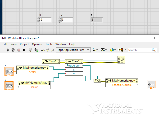

Unfortunately , the .NET I used did not return any value for me to decode. But the datatype is MXArray .
So any property or method node should work. I tried an to make an example of how to convert to the scalar value , but you have to try and see if it works. ( I could not test it yet )

Floris,
Your last post was very useful. I used your approach to construct a working VI for the simple "Rogue_sum" test function, and I think I can now generalize the approach to all of my actual MATLAB functions. Thank you!
