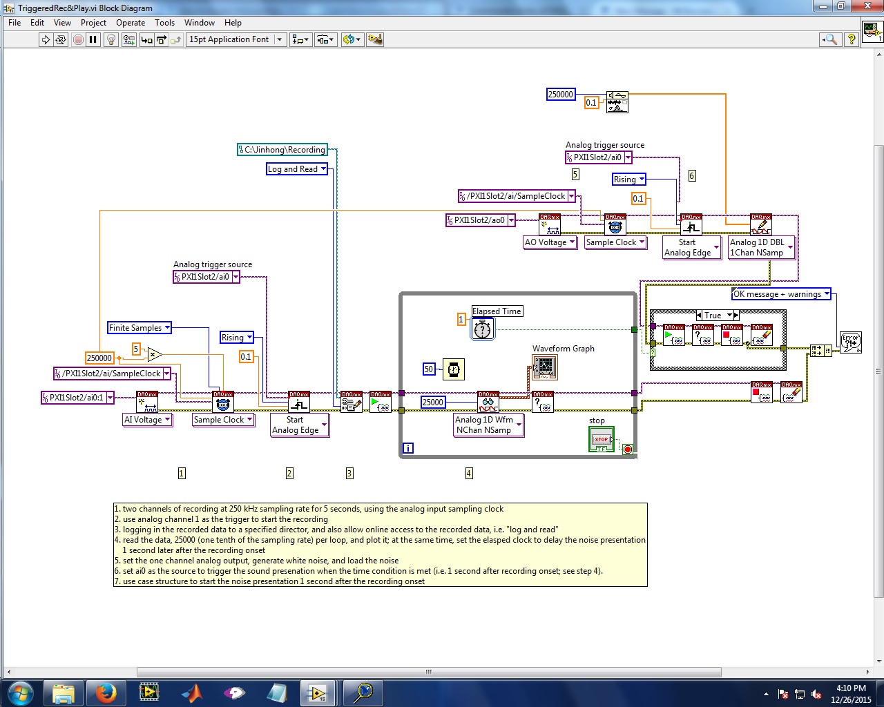

Hi! I am trying to make a program that can do sound presenation based on informaton from one analog input channel. That is, I want to start to present noise when one of my microphone has received a signal with its level above a threshold. Also, I only want to do the noise presenation after 1 second of the onset of the recording. In other words, i want to ignore events in the first second after the recording system starts. As is shown in the attached file, as well as in the screen shot, I have prepared such a program. However, I continually receive the error message saying that there is some problem with the trigger setting. But why it is invalid?
When I read the examples showing how to use analog input to trigger recording or analog output, they always use APFI. But as I said, I want to use a specific analog input channel as a trigger source. By the way, my daq card is PXIe 6358, and thus it has the analog triggering function.
I know this question can be very naive and I possibly have misunderstood APFI or analog trigger in general. Please feel free to teach me.
"Possible reason(s):
An attempt has been made to use an invalid analog trigger source.
Ensure that the trigger source you specify matches the name of the virtual channel in the task or matches the name of a non-scannable terminal that the device can use as an analog trigger source.
Property: Start.AnlgEdge.Src
Corresponding Value: PXI1Slot2/ai0
Valid Choices: APFI0, APFI1
Task Name: _unnamedTask<6>"

    Yes, you are absolutely right that I try to make simultaneous multi-channel sound recording and use one of the input channel to trigger noise presentation. The trigger signal is bat sonar cry. Since I am working in the lab and the only interfering sounds are the noise that I present, I am sure that using the level of the bat cry as a criterion to trigger noise presenation is suitable. After I calibrate the recording system, I will have clear information about the input channels regarding how loud is the bat cry and its corresponding digtal level that will be finnaly taken as the level threshold. I did something similar during my PhD, yet with tottaly different system.

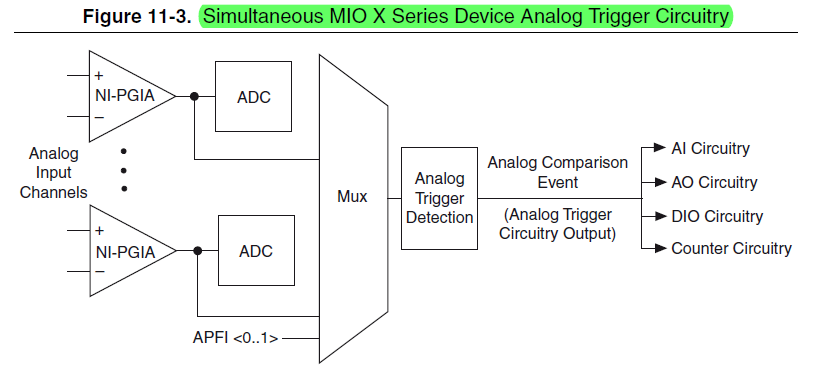

    About the suggestion of incorporating the full-wave rectifier, I did not fully get it. Do you mean to incorporate it as a hardware before DAQ sampling, or do it through software DSP after DAQ sampling? If you mean hardware manipulation, I don't have such a device at this moment. If you mean soft-ware DSP, I see another potential problem: the speed of reaction. As you can see from my codes, I will only have access to the samples in the while loop after calling the function DAQmx Read (step 4). However, the loop is a slow process and only runs every 50 ms. It can go a little faster but won't be faster than a few dozens of milliseconds. On the other hand, I want to achieve a very fast response to the bat cry, which is about 1 ms. Note here it has nothing to do with the 1 second of delay, which serves for a different purpose. Thus, this can only be done before DAQms Read or before software control. According to my understanding, NI DAQ device first samples the sounds to FIFO buffer (which is before ADC process), and the DAQmx Triggering have direct access to FIFO buffer (see inserted picture).AnalogTriggerCircuitry.png
    So my best guess for the possible solution to my problem would be sticking to the analog triggering. However, I am very new to Labview, as well as to NI devices, and I do not fully understand the concept of APFI that is used as analog triggering source in the NI examples. Is it working as another Analog input channel that I can connect a microphone to and thus use it for triggering?
    Moreover, it should be possible to use any of the analog input channels for triggering purpose. I would be very surprised that if there is no this function for NI DAQ devices
