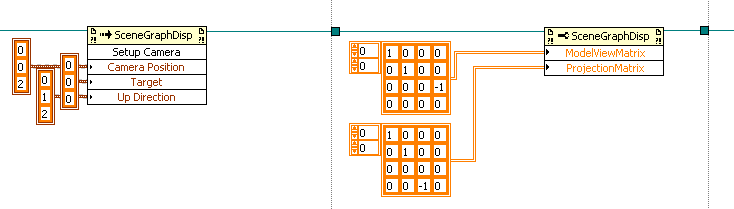

The way I did it was to keep everything within -1 to +1 on teh X and Y scale and then set the viewport to this range.  This leads to a distortion of the aspect ratio of the 3D graph isn't square, but for my application it was fine.  I'll see if I can fidn some code this evening and post a picture of my diagram.
Kind of depends on whether you're bothered by aspect ratio distortion or not.
Greetz
Shane
Message 7 of 9
(7,384 Views)
Here's what I did to force the corners of the 3D picture to always display -1 to +1 no matter the aspect ratio and without any 3D perspective.
To the best of my knowledge this removes any 3D perspective operations from the display and basically acts as a projection onto a 2D plane.  It's like working with a 2D picture but textures are handles much better.
Shane
