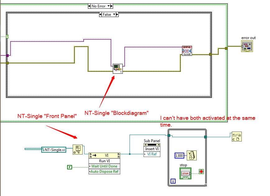

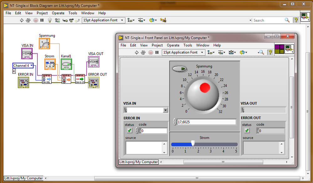

Thanks for answering. My goal is to control a power supply using RS232. This power supply has four channels. The user shall set up all four channels and hit a "Transfer to Power Supply"-Button.
I have modeled one power channel as a sub-vi NT-Single. It has controls to enter the voltage (spannung), the current (strom) and there is a "Channel 4" option visible in the block diagram where I can tell the subvi NT-Single which channel to program. Also there is an error IN and OUT and a connection to the VISA.2018-08-24 SubVI.png
 The VISA to the power supply should be opened by the controlling VI, lets call it NT-Master. NT-Master shall open the VISA connection, initialize things, call NT-Single four times and close the VISA again.
I have included NT-Single in NT-Master using the Select VI... option. This gives me access to the VISA IN/OUT and ERROR IN/OUT but the front panel is missing.
I have included NT-Single in NT-Master using the construct shown. This has lead to the confusion described in my first posting. 2018-08-24 SubVI 2.png
