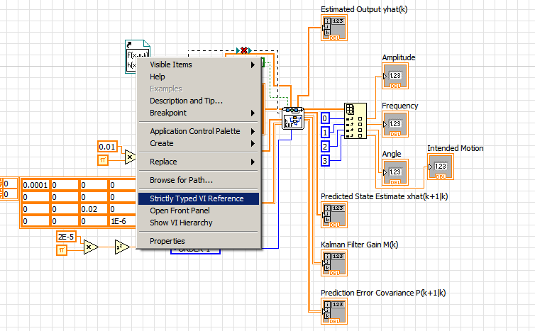

Accepted by topic author Agus Herryanto
You can right click on the Static VI Reference and select Strictly Type
19527i07EC1B162A2CB438
Andy Chang
Message 4 of 9
(4,972 Views)
Thank you for your help. This really solved my problem.
