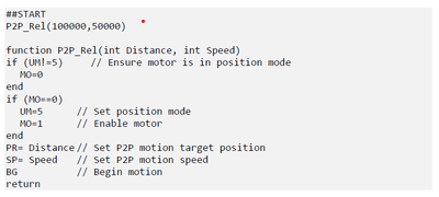

I need to do following steps
First set position mode to 5  (Command is UM)
Second to set motor on (command is MO)
Third is to Specify motion target position (PR)
fourth is to set the motion speed (SP)
fifth begin motion (BG)
I have programme in elmo language (From the manufacturer)
Looks like this are the same step what I described above.
But have no idea how to programme the same in labview, how to use write same command in labview (VISA) to perform the operation.
