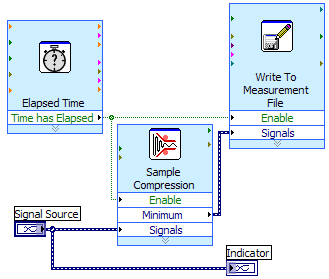

The "Write to Measurement File" express VI has an 'Enable' input that allows you to turn off the datalogging with just a boolean input.
The easiest way would be to use the "Elasped Time" express VI and set it up for 60 secondes and have it automatically reset. (You'll see this in the configuation dialog) Connect the 'Time has Elapsed' output form this to the 'Enable' input of the file writer. You could also use the "Sample Compression" express VI to reduce the amount of data that gets written to the file while keep the all the data for display.
There are plenty of other ways to to do this not using express VIs, but this by far the easiest.

Not knowing the complete plan for your data, I just wanted to point out that you may want to save an average value over that 60 seconds versus the value at that instant.  You mentioned long term trending and savig the average values may be the way to go.

Thanks Ed, thats exactly what I was trying to do!
And thanks Greaper for the averaging tip!
