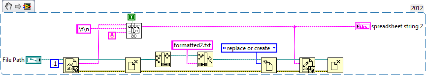

Wouldn't it be easyer to remove the extra tab at the end of each line of the data file instead?
Ben64

@ben64 wrote:
@apg504 wrote:
Thanks to altenbach (see http://forums.ni.com/t5/LabVIEW/How-can-I-restructure-an-unfavourable-2D-array-format-to-1D/m-p/2463... I've managed to arrange my 2D array data into a 1D column. Unfortunately the format of the data files is tab delimited, which wouldn't be a problem, except there is an extra tab on the end of each row, generating a zero for every 6th element in the column. Having reshaped the original 2D array into a 1D array, how can I remove all these zeroes? Attached is a sample data file of the original 2D data for one measurement and the 1D corrected version I've managed to generate for all data; note the 2D raw data file also has a header and footer, which I've been able to remove myself...
Ben64
I'll explore this method, thank you...

The code I added in my previous post will do that for you. Have you try it?
Ben64

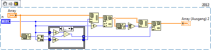

I was gonna say what altenbach said! Smiley Wink
Makes me feel smart.
Just to answer the original question:
Regards
Florian

Florian.Ludwig, I wonder how Reshape Array works with memory alocation? If it uses the same phisical memory, your solution is better than my. However, if I understand the manual literally ("... reads the array data in memory from left to right, row by row ... adjusts the array data in memory ... "), the memory is realocated.
