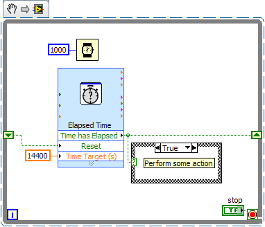

Good catch Lynn!
There is an express vi called "Elapsed Time" which might make the problem simpler.
Message Edited by Nickerbocker on 09-30-2009 03:28 PM
Message 8 of 10
(3,795 Views)
Nickerbocker wrote:
Good catch Lynn!
Isn't that what I said? I don't think you want the shift register. It will automatically reset after the target and not go high until another 4 hours have elapsed.
Message 9 of 10
(3,792 Views)
So you did.  I read the authors last post and saw something with divisors = 0 and thought that the simple answer was overlooked.
BUT, did you provide a snippet?
