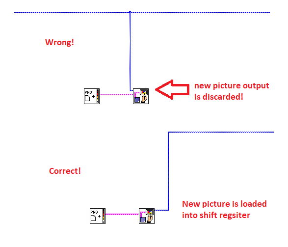

When you read the picture, you are converting the image data to a picture, but never use the output.
(Make sure you understand the difference between an input and an output!)
