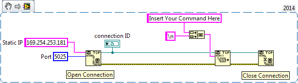

Try this code. I use a fair amout of Agilent equipment and this has worked extremely well for me. I have all my instrumentation set up with static IPs, I don't think it would work with dynamic addressing.  p.s. Most Agilent hardware needs a "newline" character (\n) to terminate the command. Don't immediatly close the conenction if you have multiple commands that you want to send. Just remember to close it later.

Thanks for the suggestion.   I was able to set  up a communication using  MAX; RAW socket.  Your code example gave me a clue to where I was going wrong.   I entered the wrong port number when creating a connection.   I needed to use the 5025 as the port #.   And enter the ip address in the upper box.   Then I was able to successfully create a resource.   thanks again.
