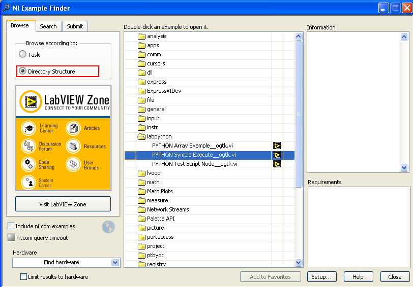

There is no example folder in LabVIEW 2010. However, in the Example Finder, by browsing according to Directory Structure, I was able to find the labpython example folder. Attached is an image for future reference.

Hmmmm.  There is an example folder in my LabVIEW2010 folder.
Thanks for the future reference pic but to be honest, the Example Finder is a really basic, LabVIEW 101 concept.  (That's probably why a power user like Rolf didn't understand your question.  Smiley Wink)
Not only is it a great reference but it's a good way to jump start your own VIs.  Simply find the example that's closest to your desired app, edit it, and rename.  Have fun browsing through it too.  You'll get lots of ideas which you can incorporate into your own work.
