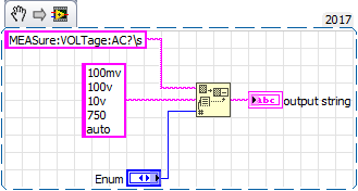

I would probably do something like this:

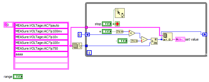

Sorry for it..
in file Valueset.
- I want add the buton "range"
- "range"  must have the defaul value from string list it must set the "auto" value in  output…..
-  "+"    "-" down and up on the string table
- and the value must go out from the loop - 1 string command.
I communicathe with the Agilent 3661a and a want to send the comand to "visa write" to set the
"range"
Message 8 of 19
(3,818 Views)
Hi Pawel,
your VI already does all you need…
Some cleanup:
- No need to spin this loop as fast as possible! I used WaitForFrontpanelActivity, but an event structure would allow more UI features…
- Why is there an "aaaa" entry in your array?
- I would use ring controls to select the needed range instead of "+"/"-" buttons…
- Why do you need a "range" button when all you can do is using the "+/-" buttons?

Hi GerdW
"aaaaa" its my mistake I must delete it 🙂 if you open the new  Vi I delete it
"Range" button set the "auto" value from list..
It must work similar that the real button..
- 6 string table's
It hard to say,
I get a measure from my device….. but I want to change the range of out value.
When I click button for example: "-" the value range change from "auto" to \s100mv and now when I get the measure one more time the value range will change…
