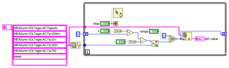

No, that "aaaa" element is still available in the first array constant…
When you don't know how to edit array constants: there is a "Training" section in the header of this LabVIEW board!
You didn't take any of my improvements of your VI: is there a reason for?
"Range" button set the "auto" value from list..
Now "range" selects the first entry from your array constant:
It must work similar that the real button..

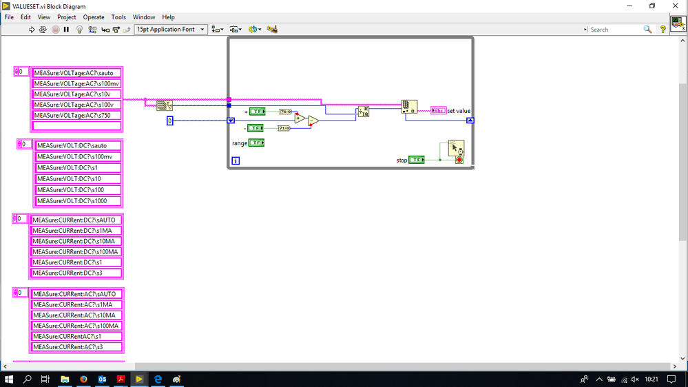

Message 12 of 19
(1,186 Views)
Message 13 of 19
(1,185 Views)
Hi Pawel,
now there is an empty string instead of the "aaaa" - but that still is not correct!
Do you know the difference between an empty string and non-existing element in that array? (Have you ever tried to right-click the element and delete it?)

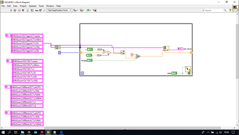

I change it….
it's ok?
Message 15 of 19
(1,178 Views)
Hi Pawel,
I change it….
Hiding an array element by resizing the array is something completely different than deleting an element…
it's ok?
I assume no - but I cannot be sure just by looking at a picture of your code.
Examining/debugging code would be much more safe…
Message 16 of 19
(1,180 Views)
@pawel1989 wrote:
I change it….
it's ok?
An index is an integer, so keep it blue. No need for orange. Make sure you know the difference There is also no need for all these wire bends and overlapping elements.

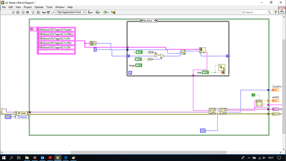

I have two simple question:P
In Vi "AC Read" I want to get the measure trom device... but I want to control the configuration of the measurement....
File VALUESETac - this Vi have the string list on command.....
And now..
How make when I click the boolean control in AC Read Vi..... the  Boolean in Valuesetac change value....
and other problem is.... the comand value don't want to go from the loop....
Message 18 of 19
(1,149 Views)
Hi Pawel,
please stick with your thread to keep all needed information in one place!
It already does it this way - but just once when you start ACRead!
It's all about THINK DATAFLOW -  the basic principle in LabVIEW.
Did you take the beginner tutorials offered in the Training section in the header of this LabVIEW board?
Here the same applies: THINK DATAFLOW! (Did you take those beginner courses?)
The value will "get out of the loop" as soon as the loop is finished (THINK DATAFLOW!): you need to press the stop button in ValueSET to end that loop…
